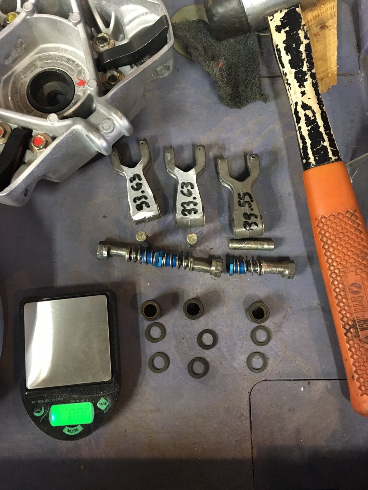

MrGutz Posted September 3, 2017 Author Report Posted September 3, 2017 The Clutch is back from Fett Brothers and I now I needed to balance the Internals. Quote
